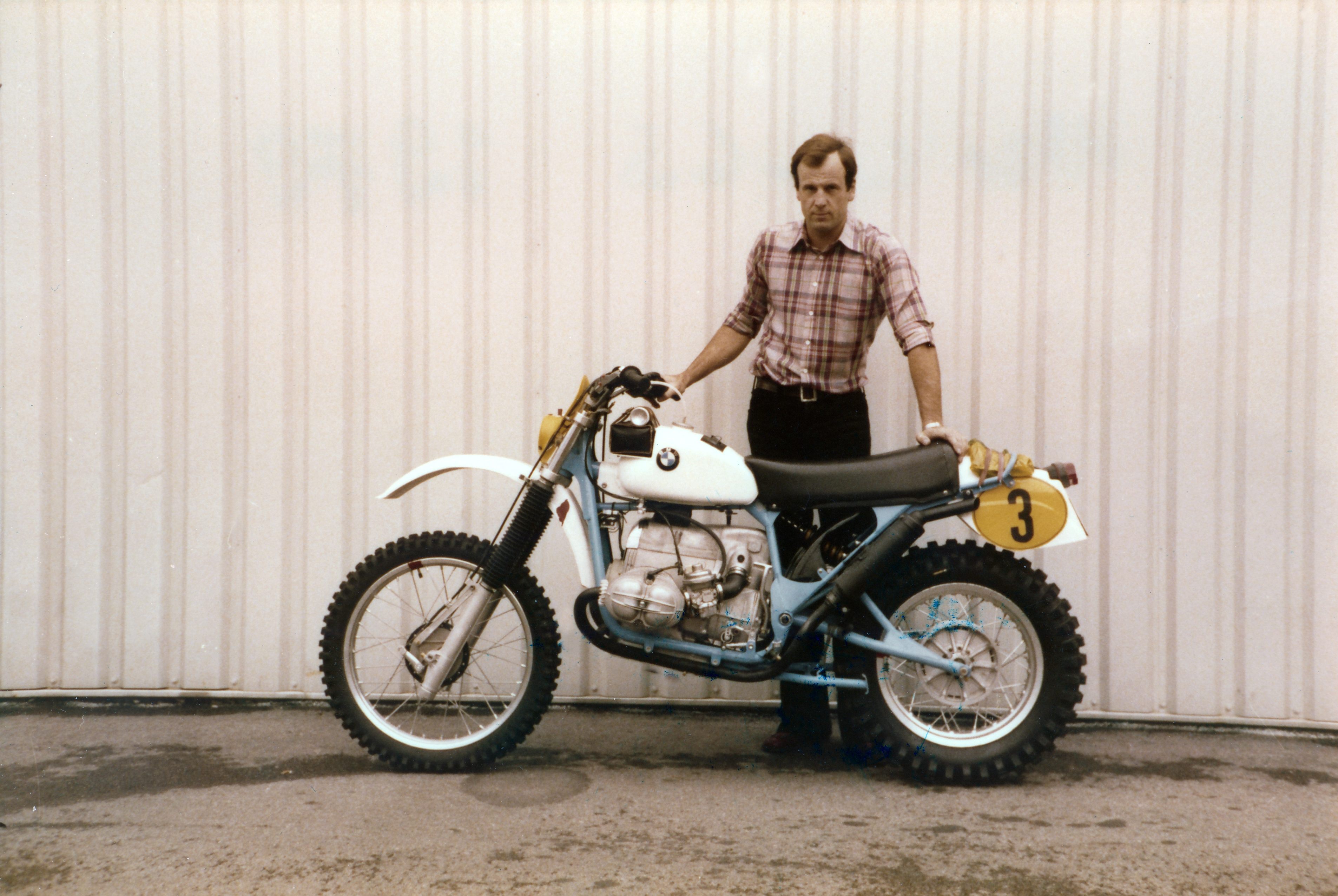

Bonjour Pierre,

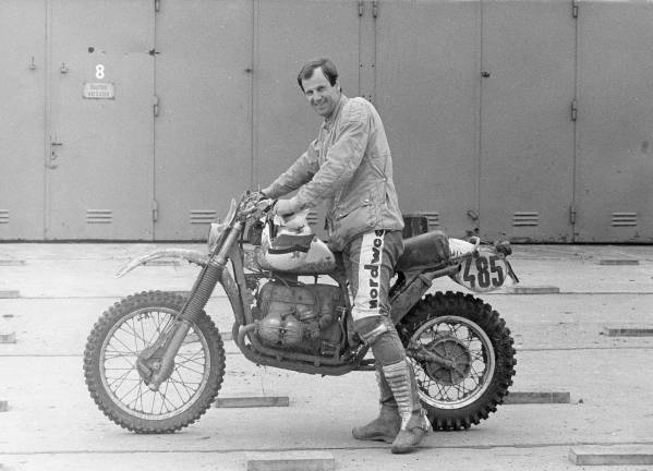

In the late 70s Herbert Scheck and Laszlo Perez used Yamaha XT500 exhausts. The exhausts used are from the first modell year of the XT 500 (I think 1U6) from 1977. The exhausts themselves are rare and sought after.
Hope I could help!
Kind regards
Jonas
P90063662-bmw-motorrad-30-years-gs-laszlo-peres-07-2010-599px.jpg P90063662-bmw-motorrad-30-years-gs-laszlo-peres-07-2010-599px.jpg (183x)
Mime-Type: image/jpeg, 36 kB
21.05.25 21:36

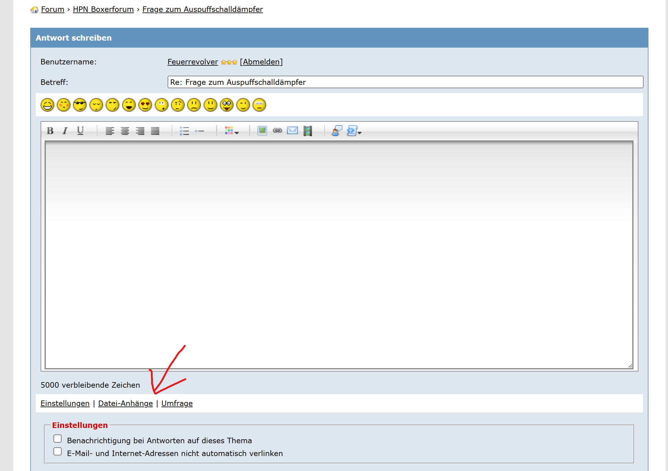

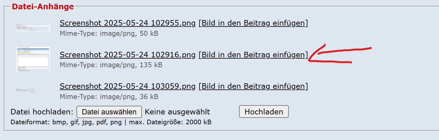

24.05.25 10:37
Feuerrevolver
Re: Frage zum Auspuffschalldämpfer

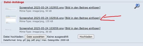

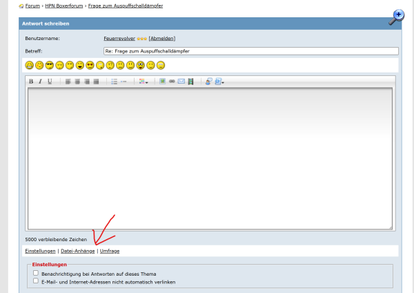

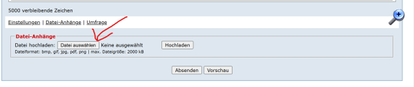

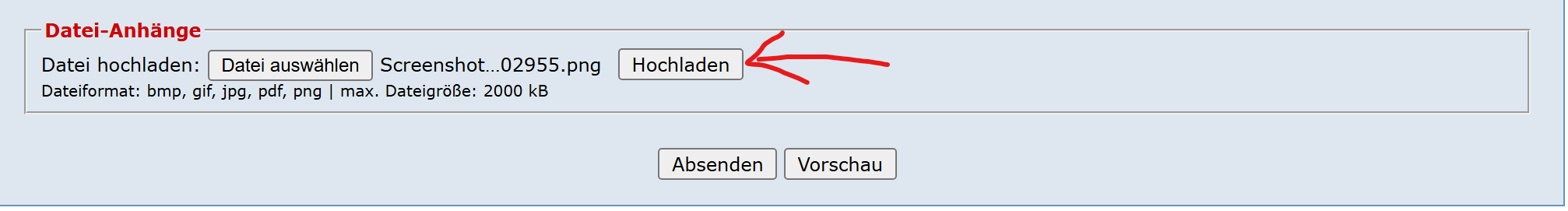

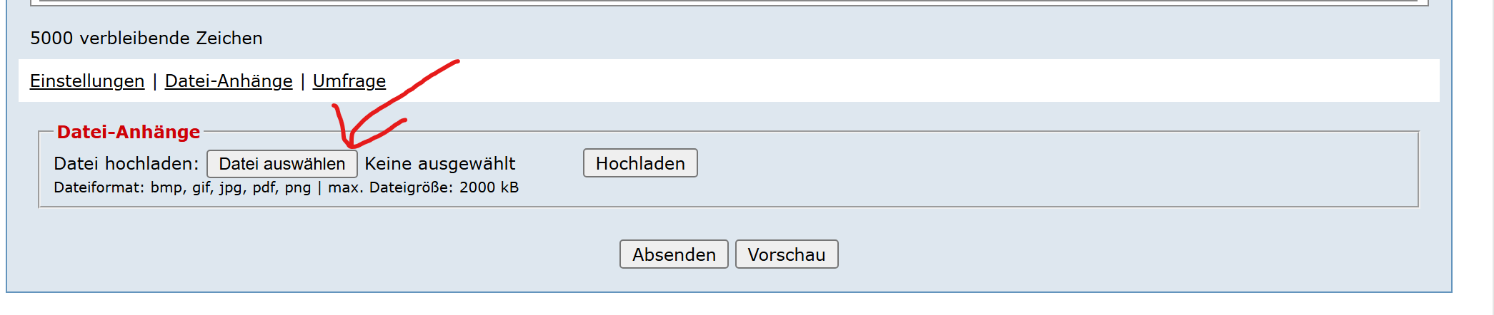

Click "Datei-Anhänge" = attachments
Click "Datei auswählen" = choose file
Click "Hochladen" = upload
Click "Bild in den Beitrag einfügen" = add picture into the post
And that's how you insert pictures, hope it helped!
